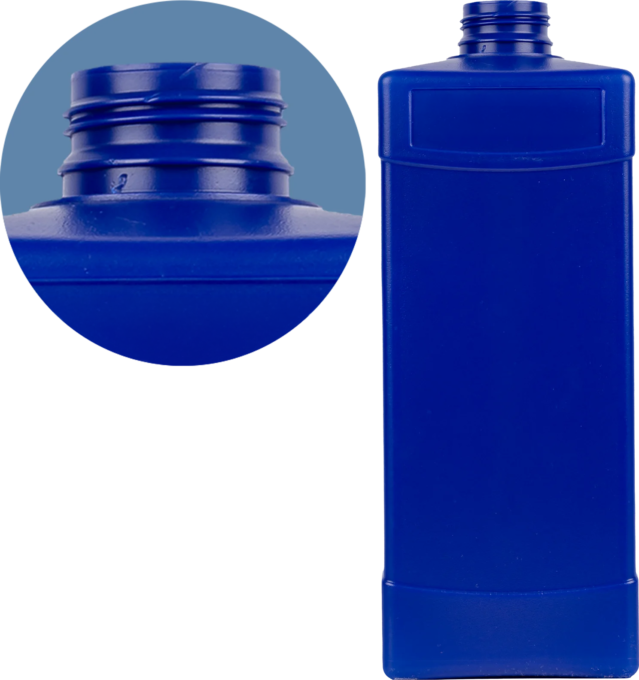

Bottle B2-A
BASIC DATA
Nominal capacity:
2 L
Thread standards:
Ø 38 mm
Material options:
HDPE
Aplications:
Industrial chemicals
Household chemicals
AVAILABLE VARIANTS
Parameter
Value
Certificates
Weight:
110 g
Colors:
blue
(others to be agreed with our employee)
Seal type:
foam-PE
View stripe
not available
Tactile warning sing
available
IML Label
not available
Printing
available
Customer sign
not available
Type of seal (Ø38)
breaking ring
Thread type
Ø38C/ SK 38/23
Dimensions
Parameter
Value
Comments
Weight:
110 g
±2 g
Parameter
Value
Comments
Length:
94 mm
±1 mm
Width:
103 mm
±3 mm
Height:
272 mm
±3 mm
AVAILABLE CLOSURE TYPES closing force
Ø38C/: 3–5 Nm
Bericap SK 38/23: 2,4–3,6 Nm

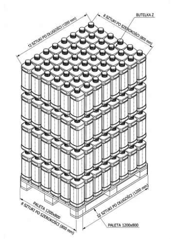

PALLETIZATION AND STORAGE – EMPTY PACKAGING
Packing system no
sT96P672
Label content
manufacturer's name, production date
product type, product quantity (pcs.)
batch number, quality mark
Storage
Protect from sun and atm.conditions
at least 1m from heat sources
ambient temperature to 40°C
Shelf life
12 months from delivery
Filling temperature
max. 40°C
Pallet Type
1200×800 mm
Spacers
cardboard trays
Pallet module
7 layers, stretch foil
Quantity per layer
96 pcs.
Quantity per pallet
672 pcs.
Pallet weight
90-100 kg
Pallet height
2,2 m
Seasoning before filling
min. 10 h at . 16–25°C
TRANSPORT - EMPTY PACKAGING
Transport:
protection against precipitation, deformation, dirt and movement
Attention:
additional loading of transport modules is not permitted
Layout on layer:
Układ na warstwie
