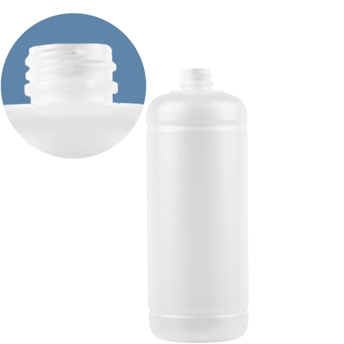

Bottle BO-1
BASIC DATA
Nominal capacity:
1 L
Thread standards:
Ø 38 mm
Material options:
HDPE ≥ 97% / dye ≤ 3%
Aplications:
Industrial chemicals
Household chemicals
agro industry
AVAILABLE VARIANTS
Parameter
Value
Certificates
Weight:
45 g
50 g
UN (II i III, to 1,2 g/cm³)
70 g
Colors:
white, transparent
(others to be agreed with our employee)
Seal type:
foam-PE, IHS (induction)
View stripe
available
Tactile warning sing
available
IML Label
not available
Printing
available
Customer sign
not available
Type of seal (Ø38)
breaking ring
Thread type
Ø38C / SK 38/23

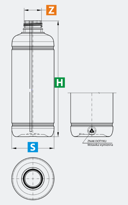

Dimensions
Parameter
Value
Comments
Weight:
45 g
±2 g
50 g
-1/+4 g
70 g
+2,5 g
Labeling field:
142(H) x 81(W) mm
Parameter
Value
Comments
Diameter:
84 mm
±0.8 mm
Height:
233 mm
±2,5 mm
