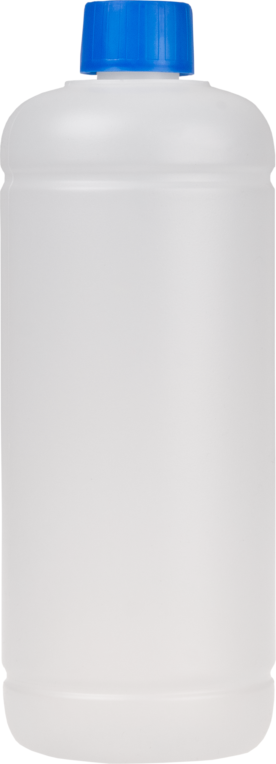

Bottle BOP-1
BASIC DATA
Nominal capacity:
1 L
Thread standards:
Ø 28 mm
Material options:
HDPE
Aplications:
Industrial chemicals
Household chemicals
agro industry
AVAILABLE VARIANTS
Parameter
Value
Certificates
Weight:
38 g
Colors:
transparent
(others to be agreed with our employee)
Seal type:
View stripe
not available
Tactile warning sing
available
IML Label
not available
Printing
not available
Customer sign
not available
Type of seal (Ø28)
breaking teeth
Thread type
Ø28
Dimensions
Parameter
Value
Comments
Weight:
38 g
+3 g
Parameter
Value
Comments
Diameter:
83 mm
±1 mm
Height:
225 mm
±1,5 mm
AVAILABLE CLOSURE TYPES closing force
Ø28
S113-01 (spryskiwacz z bezpieczną dyszą)
PALLETIZATION AND STORAGE – EMPTY PACKAGING
Packing system no
sT144P1296
Label content
manufacturer's name, production date
product type, product quantity (pcs.)
batch number, quality mark
Storage
Protect from sun and atm.conditions
at least 1m from heat sources
ambient temperature to 40°C
Shelf life
12 months from delivery
Filling temperature
max. 40°C
Pallet Type
1200×800 mm
Spacers
cardboard trays
Pallet module
9 layers, stretch foil
Quantity per layer
144 pcs.
Quantity per pallet
1296 pcs.
Pallet weight
80-120 kg
Pallet height
2,3 m
Seasoning before filling
min. 10 h at . 16–25°C
TRANSPORT - EMPTY PACKAGING
Transport:
protection against precipitation, deformation, dirt and movement
Attention:
additional loading of transport modules is not permitted
Layout on layer:
Układ na warstwie
STORAGE AND TRANSPORT – FILLED PACKAGING
Completing:
The packaging manufacturer recommends stacking filled canisters in a maximum of three layers, using cardboard dividers on each layer. Completed filled canisters should be wrapped in stretch foil.
Storage:
in covered rooms, on flat surfaces / shelves
temperature ≤ 40°C, stacking pallet units is not recommended
protect against sun and weather conditions, keep a distance of at least 1 m from heat sources
Transport:
ADDITIONAL INFORMATION
  • The obligation to validate and confirm the compatibility of the product in the technological process, the logistics chain and in terms of compliance with the filled medium rests with the recipient.
