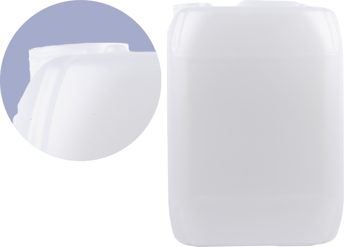

Canister K-10N
BASIC DATA
Nominal capacity:
10 L
Material options:
HDPE
Aplications:
Industrial chemicals
Household chemicals
agro industry
AVAILABLE VARIANTS
Parameter
Value
Certificates
Weight:
365, 385 g
UN (II i III, to 1,4 g/cm³)
480, 520 g
Colors:
white, transparent, other
(others to be agreed with our employee)
Seal type:
foam-PE
View stripe
available
Tactile warning sing
available
IML Label
not available
