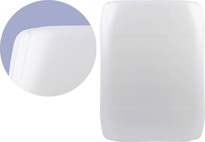

Canister K-20N2
BASIC DATA
Nominal capacity:
20 L
Thread standards:
Ø 52
Material options:
HDPE
Aplications:
Industrial chemicals
Household chemicals
agro industry
AVAILABLE VARIANTS
Parameter
Value
Certificates
Weight:
740 g
UN (II i III, to 1,3 g/cm³)
800/830 g
900/940 g
960 g
Colors:
white, transparent
(others to be agreed with our employee)
Seal type:
foam-PE
View stripe
available
Tactile warning sing
available
IML Label
not available
Printing
not available
Customer sign
available
Type of seal
breaking teeth
Thread type
52M, Suwary
Dimensions
Parameter
Value
Comments
Weight:
720/740 g
+30 g
800 g
+30 g
830 g
-20 g
900 g
+30 g
940/960 g
+30 g
Parameter
Value
Comments
Length:
288 mm
±4 mm
Width:
256 mm
±4 mm
Height:
376 mm
±6 mm
AVAILABLE CLOSURE TYPES closing force
Suwary 52M: 9-11 Nm

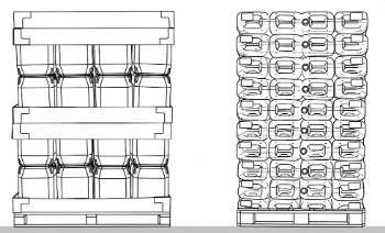

PALLETIZATION AND STORAGE – EMPTY PACKAGING
Packing system no
sT12P72 / sW8P160 (po potwierdzeniu)
Label content
manufacturer's name, production date
product type, product quantity (pcs.)
batch number, quality mark
Storage
Protect from sun and atm.conditions
at least 1m from heat sources
ambient temperature to 40°C
Shelf life
12 months from delivery
Filling temperature
max. 40°C
Pallet Type
1200×800 mm
Spacers
cardboard trays/bags
Pallet module
6 / 10 layers, stretch foil or bags
Quantity per layer
12 / 16 pcs.
Quantity per pallet
72 / 160 pcs.
Pallet weight
maks. 90 / 200 kg
Pallet height
2,5 / 2,8 m
Seasoning before filling
min. 10 h at . 16–25°C
