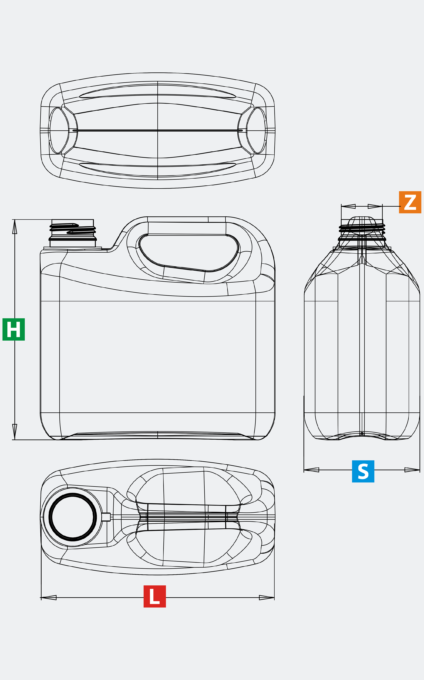

Dimensions
Parameter
Value
Comments
Weight:
80 g
±2 g
Labeling field:
90(H) x 155(W) mm
Parameter
Value
Comments
Length:
195 mm
±3,5 mm
Width:
96 mm
±3 mm
Height:
185 mm
±3,5 mm

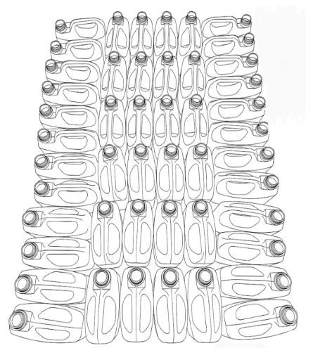

PALLETIZATION AND STORAGE – EMPTY PACKAGING
Packing system no
sT48P576
Label content
manufacturer's name, production date
product type, product quantity (pcs.)
batch number, quality mark
Storage
Protect from sun and atm.conditions
at least 1m from heat sources
ambient temperature to 40°C
Shelf life
12 months from delivery
Filling temperature
max. 40°C
Pallet Type
1200×800 mm
Spacers
cardboard trays
Pallet module
12 layers, stretch foil
Quantity per layer
48 pcs.
Quantity per pallet
576 pcs.
Pallet weight
60 – 70 kg
Pallet height
2,3 m
Seasoning before filling
min. 10 h at . 16–25°C

Layout on layer:
Układ na warstwie
