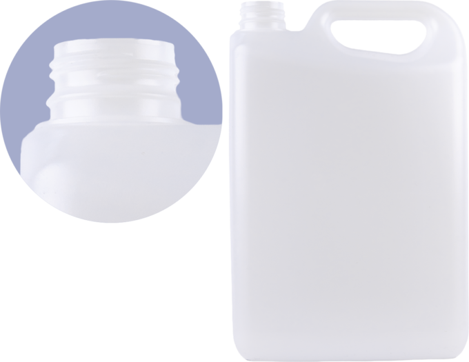

Canister K-4N
BASIC DATA
Nominal capacity:
4 L
Thread standards:
SK 38/23, Fi38C
Material options:
HDPE
Aplications:
Industrial chemicals
Household chemicals
AVAILABLE VARIANTS
Parameter
Value
Certificates
Weight:
138 g
Colors:
transparent
(others to be agreed with our employee)
Seal type:
foam-PE
View stripe
not available
Tactile warning sing
available
IML Label
not available
Printing
not available
Customer sign
not available
Type of seal
breaking ring
Thread type
Ø38C, Bericap
Dimensions
Parameter
Value
Comments
Weight:
138 g
+5 g
Labeling field:
190(H) x 160(W) mm
Parameter
Value
Comments
Length:
195 mm
±3,5 mm
Width:
96 mm
±3 mm
Height:
297 mm
±4 mm

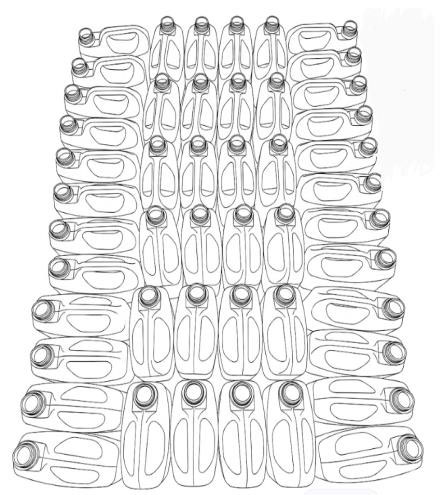

Quantity per layer
48 pcs.
Quantity per pallet
384 pcs.

Layout on layer:
Układ na warstwie
