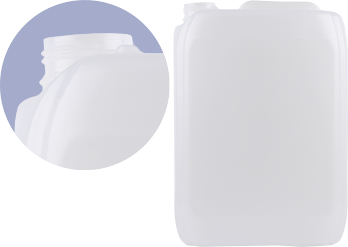

The canister has an interchangeable insert allowing the production of packaging without or with a touch sign. It also has an interchangeable insert on the side surface on which the customer’s logo and certificate number can be placed.
The size of the LOGO insert: height 72 mm, width 34 mm
Minimum dimensions of the IML label before application in mould on the canister wall at the central (middle) point of the label field:
L length 135 mm
H height 65 mm
Maximum dimensions of the IML label before application in mould on the canister wall at the central (middle) point of the label field:
L length 146 mm
H height 170 mm
The dimensions of the IML label after application in mould on the canister wall after shrinking decrease their L and H dimensions by 2-2.5%.
