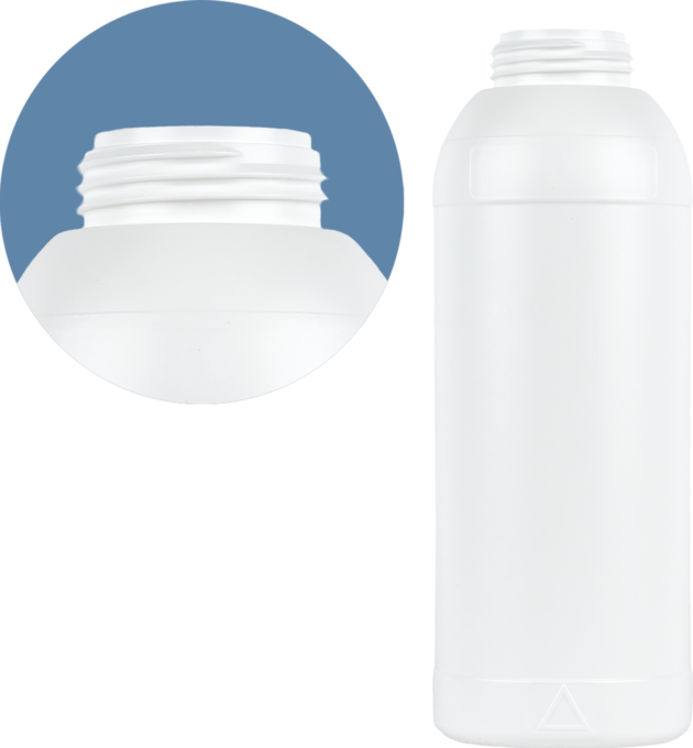

Bottle B1-SOR 50 | 63 mm HDPE | Coex
BASIC DATA
Nominal capacity:
1 L
Thread standards:
Ø 50 / Ø 63 mm
Material options:
HDPE (mono), HDPE-PA (coex)
Aplications:
Industrial chemicals
Household chemicals
agro industry
